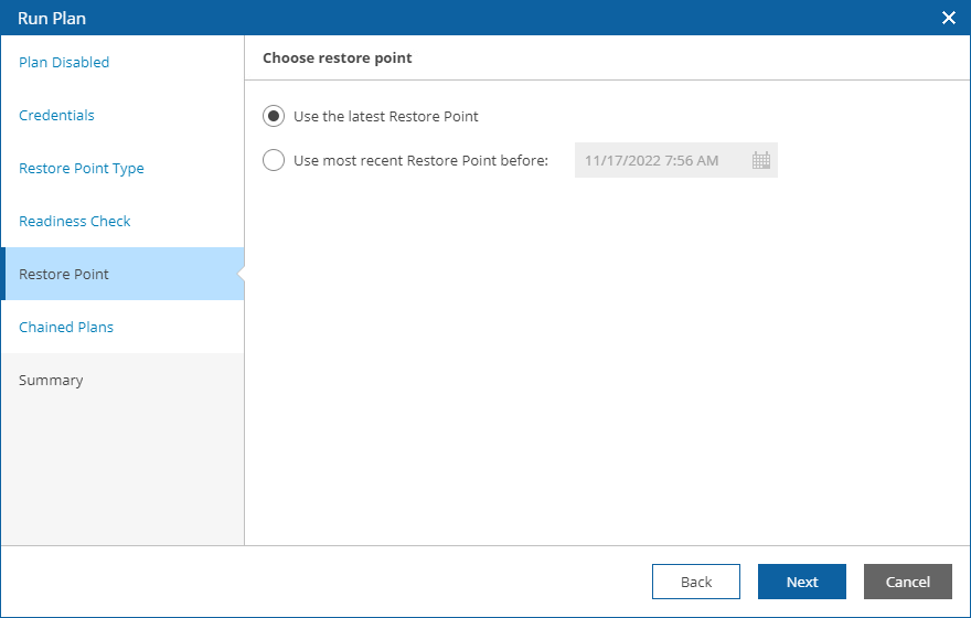

  1. At the Restore Point step, choose a restore point that will be used to recover VM replicas.
Running Failover
