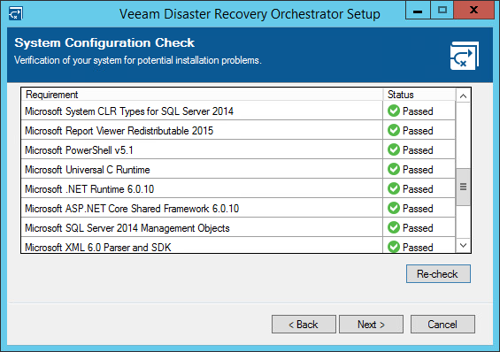

Step 5. Perform System Configuration Check

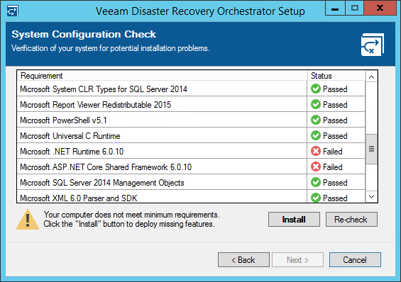

At the System Configuration Check step of the wizard, check whether all prerequisite software is available on the target system. If some of the required software components are missing, the wizard will offer to install missing software automatically. To do that, click Install.
When all the required software is installed, click Re-check to repeat verification.

Installation of the missing software may require performing a reboot. Click Reboot in the warning message to acknowledge the reboot.
