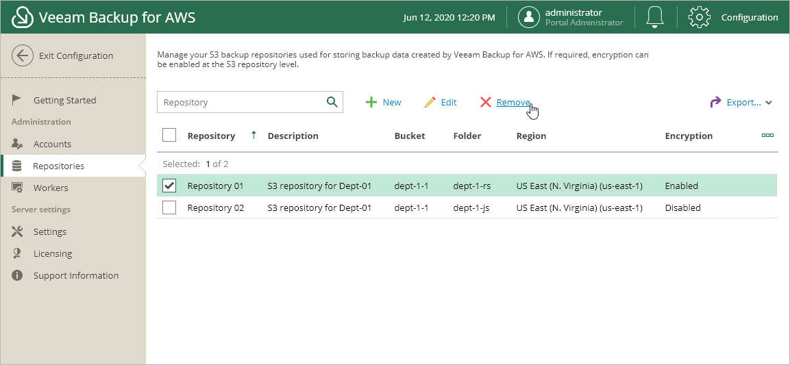

To remove S3 repositories:
  1. At the top right corner of the Veeam Backup for AWS window, click Configuration.
  2. In the configuration menu on the left, click Repositories.
  3. Select check boxes next to S3 repositories that you want to remove.
You can use the search field to find the S3 repository by name.
  1. At the top of the repositories list, click Remove.
