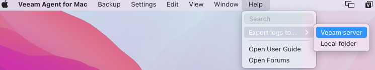

Exporting Logs Using Control Panel
To export logs, from the Veeam Agent application menu, select Help > Export logs to > Veeam server.
Exporting Logs to Veeam Backup Server.
