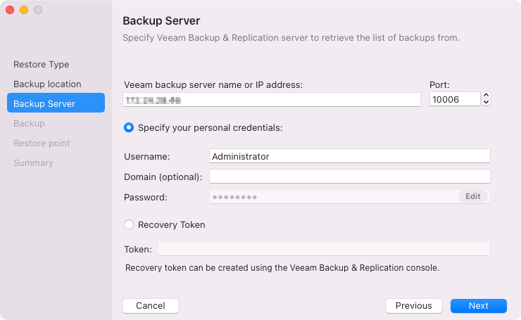

  • Login and password. With this option selected, specify the following settings:
  1. In the Login field, type in the name of the account that has access to the Veeam backup repository.
  2. Optionally, in the Domain field, type in the name of the domain in which the account that has access to the Veeam backup repository is registered.
  3. In the Password field, type in the password of the account that has access to the Veeam backup repository.
NOTE
If you want to perform restore from a backup created by Veeam Agent operating in the managed mode, you must use an account that has the Veeam Backup Administrator or Veeam Restore Operator role on the Veeam backup server. For more information about user roles, see the Users and Roles section in the Veeam Backup & Replication User Guide.

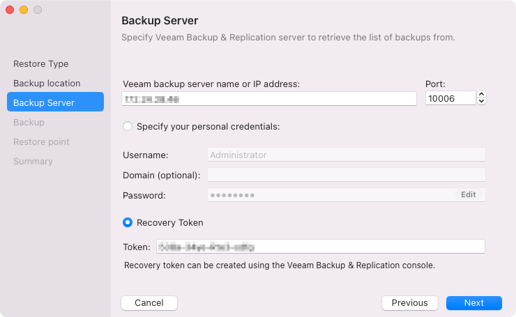

  • Recovery token: With this option selected, in the Token field, enter the value of the recovery token generated in the Veeam Backup & Replication console. For more information on generating recovery tokens, see Creating Recovery Token in the Veeam Agent Management guide.

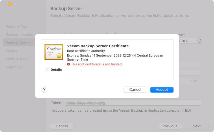

  1. Press [Enter]. Veeam Agent will connect to the Veeam backup server. If prompted, accept the self-signed certificate of the Veeam backup server to continue.
Veeam Backup Repository Settings
After successful connection to the Veeam backup server, you will pass immediately to the Backup step of the wizard.
