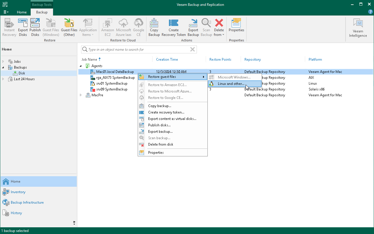

You can use the Veeam Backup & Replication console to restore individual files and folders from Veeam Agent backups.
The procedure of file-level restore from a Veeam Agent backup is similar to the same procedure for a VM backup. To learn more about file-level restore, see the Restore from Linux, Unix and Other File Systems section in the Veeam Backup & Replication User Guide.
