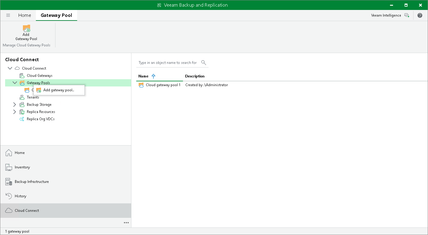

Step 1. Launch New Gateway Pool Wizard
To launch the New Gateway Pool wizard, do one of the following:
  • Open the Cloud Connect view. Click the Gateway Pools node in the inventory pane and click Add Gateway Pool on the ribbon.
  • Open the Cloud Connect view. Right-click the Gateway Pools node in the inventory pane and select Add gateway pool.
Launch Cloud Gateway Pool Wizard
