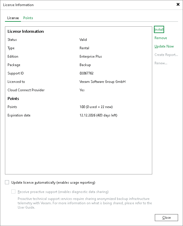

To view information about the currently installed license, select License from the main menu of the Veeam Backup & Replication console.
To install a new license or change the license:
  1. From the main menu, select License.
  2. In the License Information window, in the License tab, click Install and specify a path to the license file.
