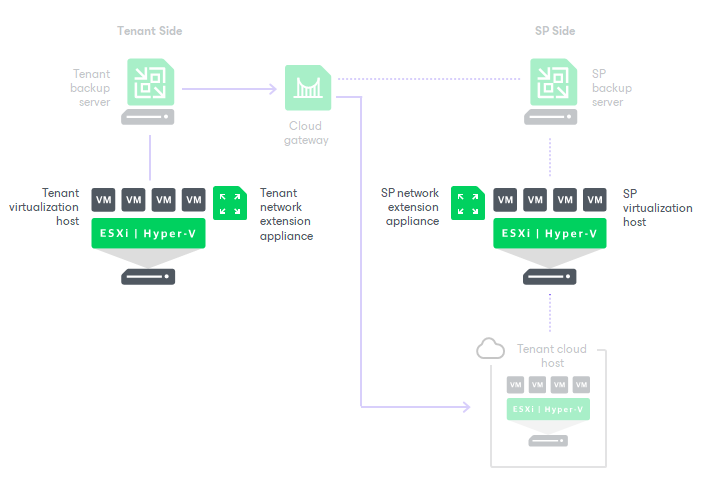

To enable communication between production VMs on the tenant side, VM replicas on the cloud host, Veeam Cloud Connect infrastructure components and external network nodes, Veeam Backup & Replication uses network extension appliances. The network extension appliance is a Linux-based auxiliary VM created on virtualization hosts where tenant VMs and their replicas reside.

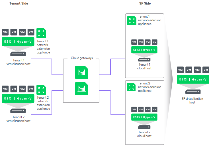

For every tenant who plans to replicate VMs to the cloud host and use all built-in cloud networking and failover capabilities (perform both full site failover and partial site failover), at least two network extension appliances should be deployed — one on the SP side and the other on the tenant side.
  • The network extension appliance on the SP side is deployed on the virtualization host in the SP environment that acts as a replication target. The network extension appliance VM is assigned an IP address from the SP production network and placed to the Cloud_Connect_Replication folder and resource pool created on the ESXi host or a dedicated folder on the Hyper-V host.
  • The network extension appliance on the tenant side is deployed on the source virtualization host where production VMs reside. The network extension appliance VM is assigned an IP address from the tenant production network and placed to the selected folder and resource pool created on the ESXi host or a selected folder on the Hyper-V host.

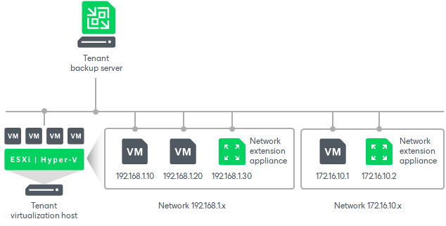

The network extension appliance connects to a production network using a network adapter. On the tenant side, a separate network extension appliance must be deployed for every production IP network. For example, if there are 2 networks on the tenant production site, the tenant should configure 2 network extension appliances. The network adapter of each network extension appliance on the tenant side gets an IP address from the production network for which this appliance is configured.
The tenant-side network extension appliance is deployed on the tenant virtualization host when the tenant adds the SP in the tenant Veeam backup console. At the Network Extension step of the Service Provider wizard, Veeam Backup & Replication offers the tenant to deploy one network extension appliance with default settings. To deploy the default appliance, Veeam Backup & Replication detects the production network, connects the appliance to this network and tries to assign an IP address to the appliance using DHCP.
When adding the SP, the tenant can check and, if necessary, specify custom settings for the network extension appliance instead of the default ones. For example, the tenant can assign a specific IP address to the appliance. If there are multiple production IP networks on the tenant side, the tenant can instruct Veeam Backup & Replication to deploy the required number of network extension appliances with required settings.

If the SP assigns to a tenant several hardware plans that utilize resources on different hosts, Veeam Backup & Replication will deploy network extension appliances for this tenant on every host that acts as a replication target.
