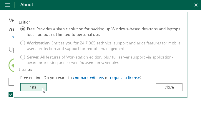

To install a license:
  1. Double-click the Veeam Agent for Microsoft Windows icon in the system tray, or right-click the Veeam Agent for Microsoft Windows icon in the system tray and select Control Panel.
  2. From the main menu, select About.
  3. In the Version section, click the following link:
  1. Update license to get additional features — if the license is not installed yet, and you run the Free edition of Veeam Agent for Microsoft Windows.
  2. Manage license and edition — if the license is already installed on the Veeam Agent computer, and you want to change the license or select the product edition.
  1. In the dialog window, click Install and browse for the LIC file.
Veeam Agent for Microsoft Windows will install the license and select the product edition that is allowed by the license. If a license supports both the Workstation and Server editions, Veeam Agent for Microsoft Windows will select the product edition based on the type of the Microsoft Windows OS installed on the Veeam Agent computer.
You can change the product edition manually if needed. To learn more, see Selecting Product Edition.
