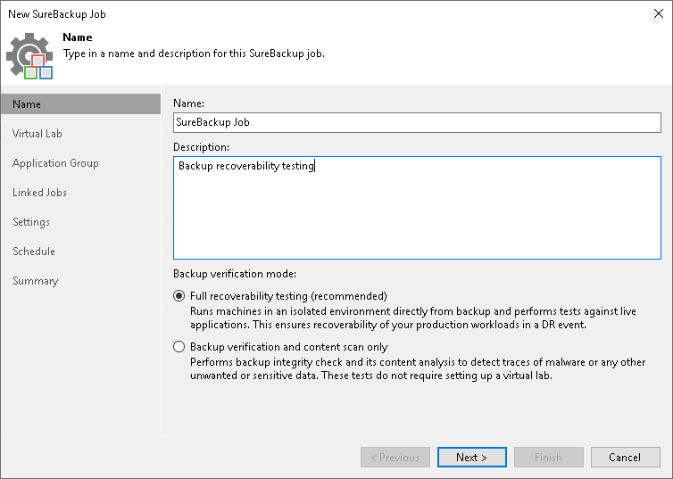

Before creating the SureBackup job, check limitations for Veeam Agent backups below. Then launch the New SureBackup Job wizard to create the SureBackup job. To learn more, see the Creating SureBackup Job section in the Veeam Backup & Replication User Guide.
