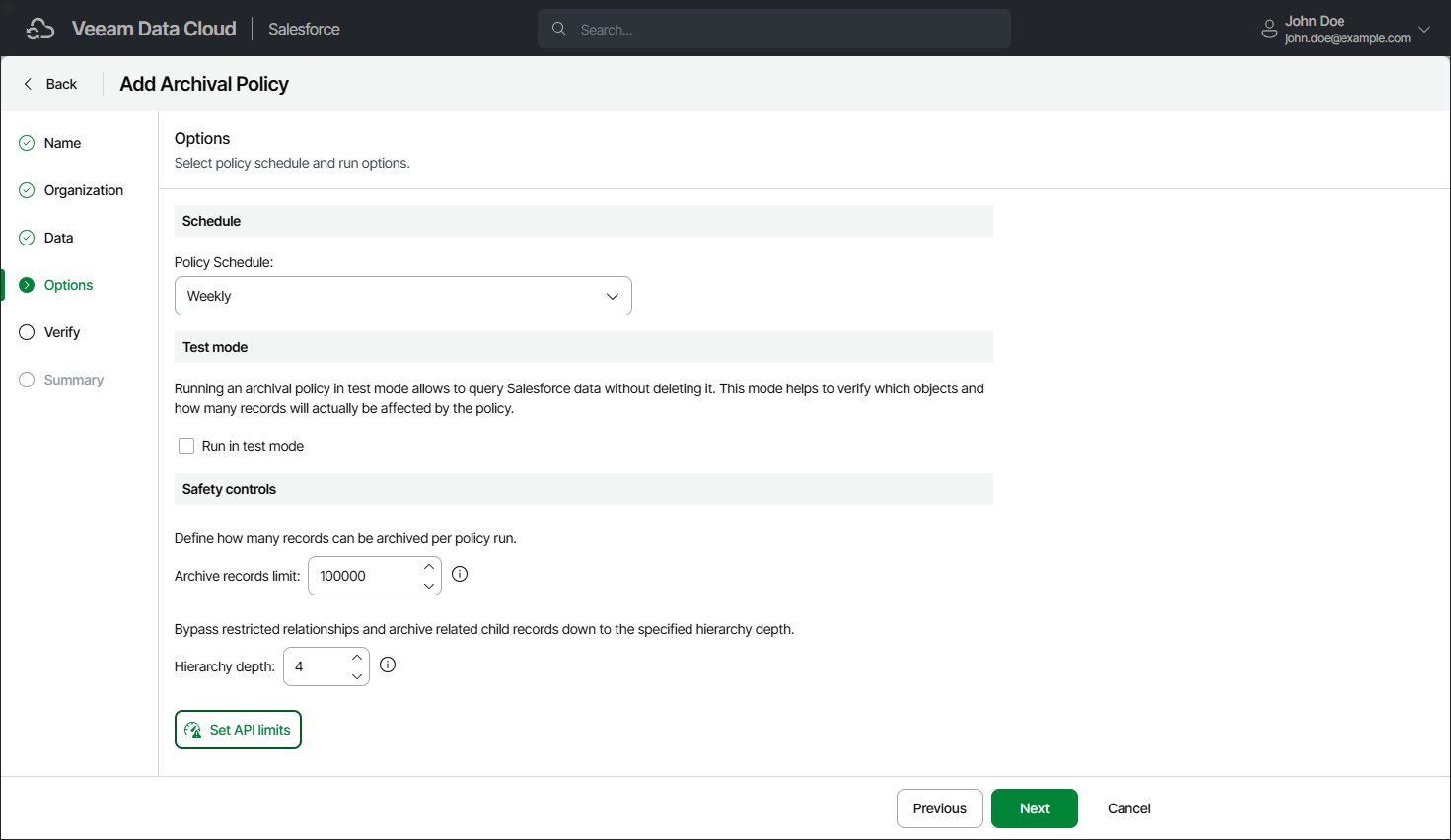

Step 5. Configure General Settings
At the Options step of the wizard, you can select an archival schedule, specify API request and safety control limits and run the policy in the test mode.
- In the Schedule section, choose whether you want to launch the policy every day, every week, every month or according to a custom schedule.
- In the Test mode section, select the Run in test mode option to to run the archival policy in the test mode without actually deleting any data. Then, either wait for the policy to run according to the selected schedule or run it manually after you finish working with the Add Archival Policy wizard. When the archival session completes, you can check the number of records that will be archived for both the selected object and all its child objects.
- By default, Veeam Data Cloud archives up to 100,000 records during one archival session to avoid performance issues. In the Safety controls section, you can adjust this limit taking into account the number of records that has been calculated at the previous step.
If the limit that you specify is less than the calculated number of records, the product will archive only the specified number of records while other records will be archived later, during subsequent archival sessions. Note that Veeam Data Cloud can archive data during subsequent archival sessions only after running the related backup policy — this allows the product to preserve data consistency between backup sessions.
- By default, Veeam Data Cloud deletes linked child records using restricted relationships (that is, required lookup field relationships and optional lookup field relationships with the Delete this record also option enabled) of the 1st and 2nd hierarchy levels only. In the Safety controls section, you can adjust the depth level. The hierarchy depth settings do not apply to master-detail relationships.

- To specify thresholds for REST API and BULK API requests that must not be exceeded during archival operations, click Set API limits and enter the necessary threshold values (in percent) in the Set API limits window. Since the total number of API requests that can be sent to Salesforce within 24 hours is limited for each Salesforce tenant, the setting will help you ensure that Veeam Data Cloud does not conflict with other applications that use API requests for integration with Salesforce. To do that
