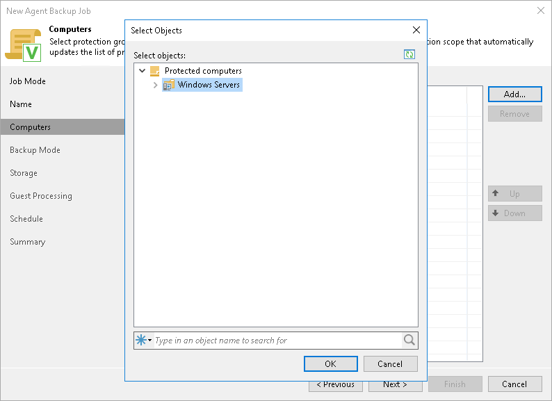

  1. At the Computers step of the wizard, click Add and select one or more protection groups or individual computers whose data you want to back up. To quickly find the necessary object, use the search field at the bottom of the Select Objects window.
Creating Veeam Agent Backup Jobs

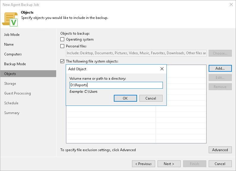

  1. If you chose the Volume level backup or File level backup option at the Backup Mode step of the wizard, at the Objects step of the wizard, specify the backup scope for the Veeam Agent backup job.
  • For volume-level backup, specify what volumes you want to include in the backup. You can include in the backup operating system data or specific volumes. You can also include in the backup all volumes except for the volume that contains operating system data or selected volumes.
  • For file-level backup, specify what folders with files or entire volumes you want to include in the backup. You can include in the backup operating system data, personal files or specific folders or volumes.

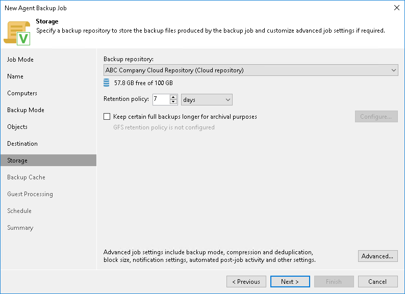

  1. At the Storage step of the wizard, from the Backup repository list, select the cloud repository to which you plan to store backup files.
  2. Specify how many restore points you want to keep on the cloud repository. To do this, in the Retention policy field, specify the number of restore points or the number of days for which you want to store backup files on the cloud repository. If you want to use the GFS (Grandfather-Father-Son) retention scheme, you can also specify how weekly, monthly and yearly full backups must be retained.
  • For a backup job managed by the backup server:
  • For a backup policy:
  1. Click Advanced.
  2. To encrypt the resulting backup file on the cloud repository, on the Storage tab, select the Enable backup file encryption check box. From the Password field, select a password that you want to use to encrypt the backup file. If you have not created a password beforehand, click Add or use the Manage passwords link to specify a new password.
[For a backup job managed by the backup server] You can select a Key Management System (KMS) server in the Password field. The KMS server must be added to Veeam Backup & Replication in advance. If you choose to use KMS keys for backup file encryption at this step of the wizard, Veeam Backup & Replication immediately starts communication with the KMS server to retrieve the encryption keys. To learn more, see the Key Management System Keys section in the Veeam Backup & Replication User Guide.

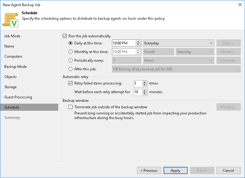

  1. At the Schedule step of the wizard, specify the schedule according to which you want to perform backup:
  • If you selected the Server or Failover cluster option at the Job Mode step of the wizard, select the Run the job automatically check box and specify the necessary scheduling settings for the job. If you do not select this check box, you will have to run the backup job manually to create a backup file in the cloud.
  • If you selected the Workstation option at the Job Mode step of the wizard, you can specify time and days when the backup job must start, as well as settings for events that trigger the backup job launch.
