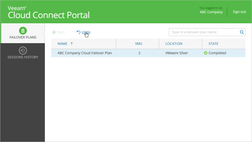

To undo failover by a cloud failover plan:
  1. Log in to Veeam Cloud Connect Portal. The Failover Plans view will automatically open.
  2. In the working area, select the necessary cloud failover plan and click Undo.
To quickly find the necessary cloud failover plan, you can use the search field at the top-right of the working area.
  1. Monitor the undo failover process and view results.
