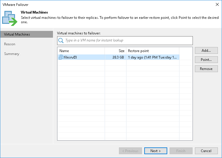

  1. At the Virtual Machines step of the wizard, select one or more VMs for which you want to perform failover.

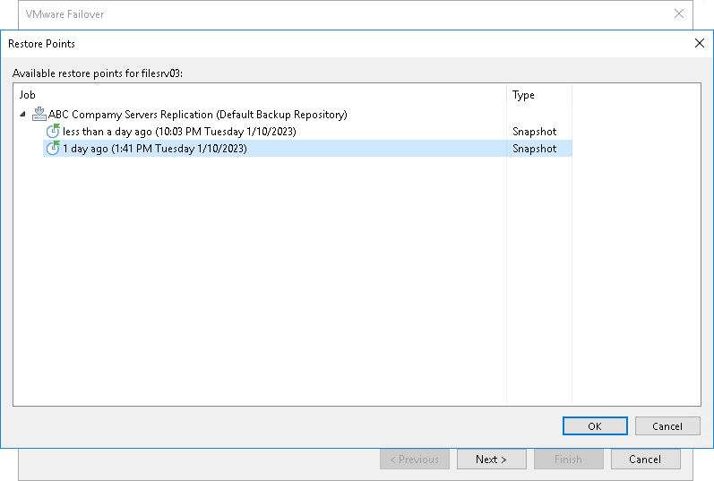

  2. By default, Veeam Backup & Replication uses the latest valid restore point of the VM replica. If you want to fail over to an earlier state of the VM, select the VM in the Virtual machines to failover list and click Point.
Performing Failover
  1. In the Restore Points window, expand the replication job that contains the VM you plan to fail over, select the necessary restore point, and click OK.

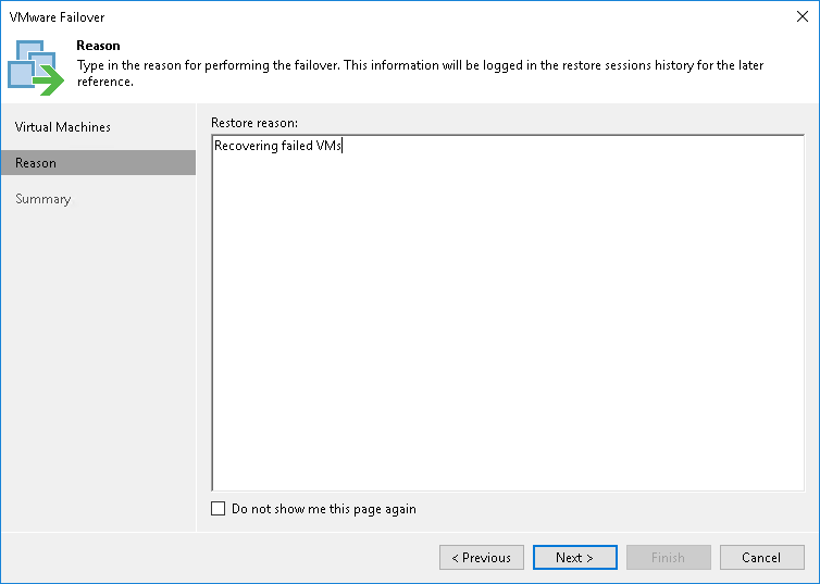

  1. At the Reason step of the wizard, specify the reason for failing over to the VM replicas for future reference.
