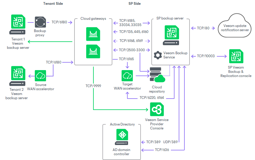

Cloud gateway
SP backup server
TCP
6169
Port on the SP backup server used to listen to cloud commands from the tenant side. Tenant cloud commands are passed to the Veeam Cloud Connect Service through the cloud gateway.
TCP
8190, 8191
Port on the SP backup server used by SP-side network redirectors to connect to the Remote Access Console and establish a Remote Desktop Connection to tenant.
TCP
2500 to 5000
Port range used during transfer of the Veeam Service Provider Console agent from the SP backup server to the tenant backup server.
TCP
6185, 33034, 33035

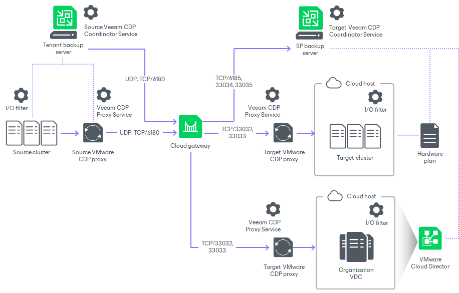

Ports on the SP backup server used for communication with the Veeam CDP Coordinator Service.
For the complete list of ports used in the CDP infrastructure, see the CDP Components section in the Veeam Backup & Replication User Guide.

SP VMware CDP proxy
TCP
33032, 33033
Default ports used as transmission channels to the target CDP proxy.

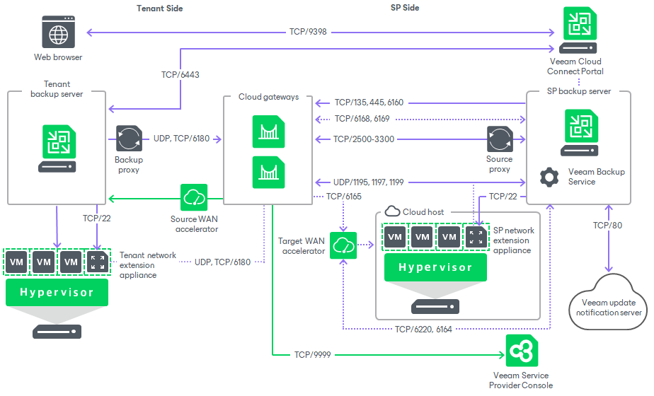

Provider-side network extension appliance
UDP
1195
Port used to establish secure VPN connection for network extension during partial site failover.
If a tenant has several IP networks, additional odd ports should be opened starting from 1195 — one port per tenant IP network.
For example, a tenant Tenant1 replicates VMs that are connected to 3 IP networks. In the Veeam Cloud Connect infrastructure, the SP deployed a network extension appliance for Tenant1. In this case, the SP needs to open between the network extension appliance and the cloud gateway the following ports: 1195, 1197, 1199.

SP backup server
Cloud gateway
TCP
135, 445
Ports used for deploying Veeam Backup & Replication components.
TCP
6160
Default port used by the Veeam Installer Service for deployment of the Veeam Cloud Gateway Service and during failover operations.
TCP
6168
Port on the cloud gateway used to listen for cloud commands from the Veeam Cloud Connect Service. The service cloud commands from the Veeam Cloud Connect Service are sent to set up, delete and check the status of data transport channels between tenants and the cloud repository.
TCP
2500 to 3300
Default range of ports used as data transmission channels. For every TCP connection that a job uses, one port from this range is assigned.
Note: This range of ports applies to newly installed Veeam Backup & Replication starting from version 10.0, without upgrade from previous versions. If you have upgraded from an earlier version of the product, the range of ports from 2500 to 5000 applies to the already added components.

Domain controller
TCP and UDP
389
Port used for LDAP connections to Active Directory domain controllers for Active Directory tenants authentication.
TCP
636
Ports used for LDAPS connections to Active Directory domain controllers for Active Directory tenants authentication.
WAN accelerator
TCP
6164
Controlling port for RPC calls.
TCP
6220
Port used for traffic control (throttling) for tenants that use WAN accelerators.
Cloud gateway
UDP
1195
Tenant-side network extension appliance
Cloud gateway
TCP and UDP
6180
Port used to carry tenant VM traffic from the tenant network extension appliance to the SP network extension appliance through the cloud gateway.

Tenant VMware CDP proxy
Cloud gateway
TCP and UDP
6180
Port used for VM data transport by CDP policies targeted at the cloud host.

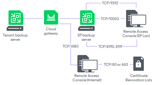

(SP LAN)
SP backup server
TCP
8191
Port used for communication with the Veeam Cloud Connect Service and SP-side network redirectors.
TCP
9392
Port used for communication with the Veeam Backup Service.
TCP
10003
(Internet)
Cloud gateway
TCP
6180
Default port used for communication with the SP Veeam Cloud Connect Service and SP-side network redirectors.

Ports in Backup Scenarios
The following diagram illustrates the interaction between Veeam Cloud Connect components and used ports in backup scenarios.
Ports in Snapshot-Based Replication Scenarios
The following diagram illustrates the interaction between Veeam Cloud Connect components and used ports in snapshot-based replication scenarios.
Ports in CDP Scenarios
The following diagram illustrates the interaction between Veeam Cloud Connect components and used ports in CDP replication scenarios.
Ports in Remote Access Console Scenarios
The following diagram illustrates the interaction between Veeam Cloud Connect components and used ports in the Remote Access Console scenarios.
