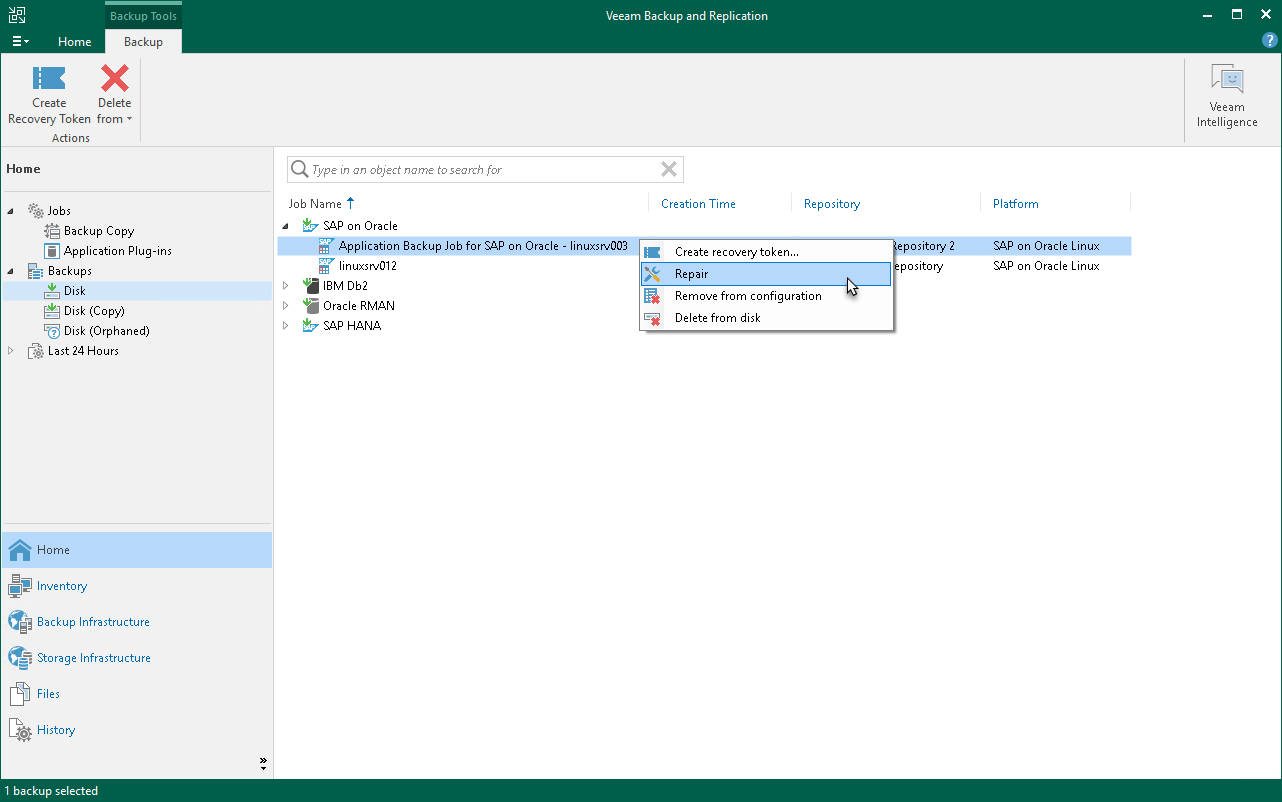

Repairing Backup
To repair a backup:
  3. In the working area, select the necessary backup.
  4. Press and hold the [Ctrl] key, right-click the backup and select Repair.
Veeam Backup & Replication will generate a new .VACM file using information from the .VASM files. Once the backup job metadata file is re-created, you can use Veeam Plug-in to restore your data.
