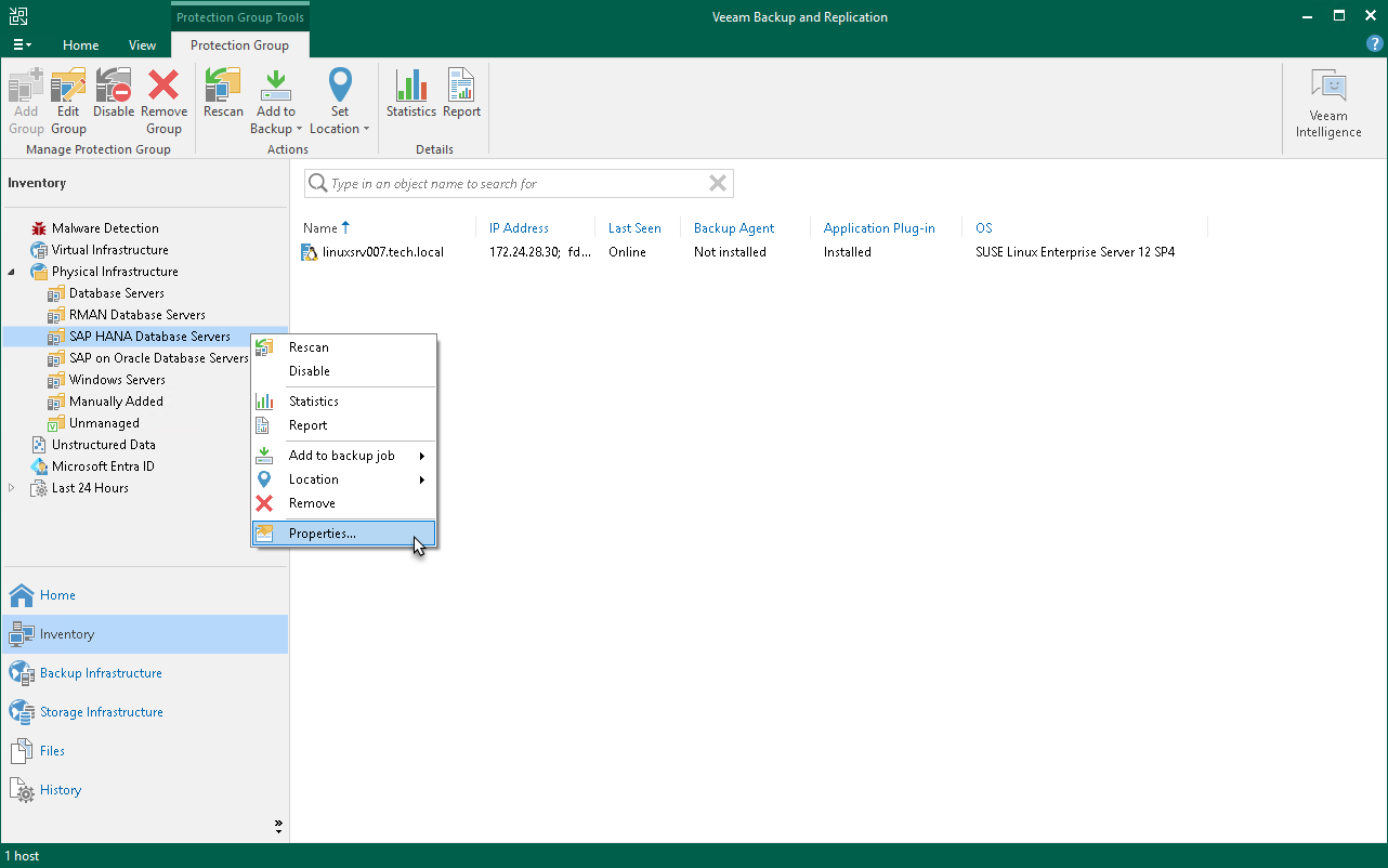

To edit protection group settings:
  1. Open the Inventory view.
  2. In the inventory pane, expand the Physical Infrastructure node.
  3. In the inventory pane, select the protection group that you want to edit and click Edit Group on the ribbon or right-click the protection group that you want to edit and select Properties.
  4. Edit protection group settings as required.
Edit Protection Group Settings
