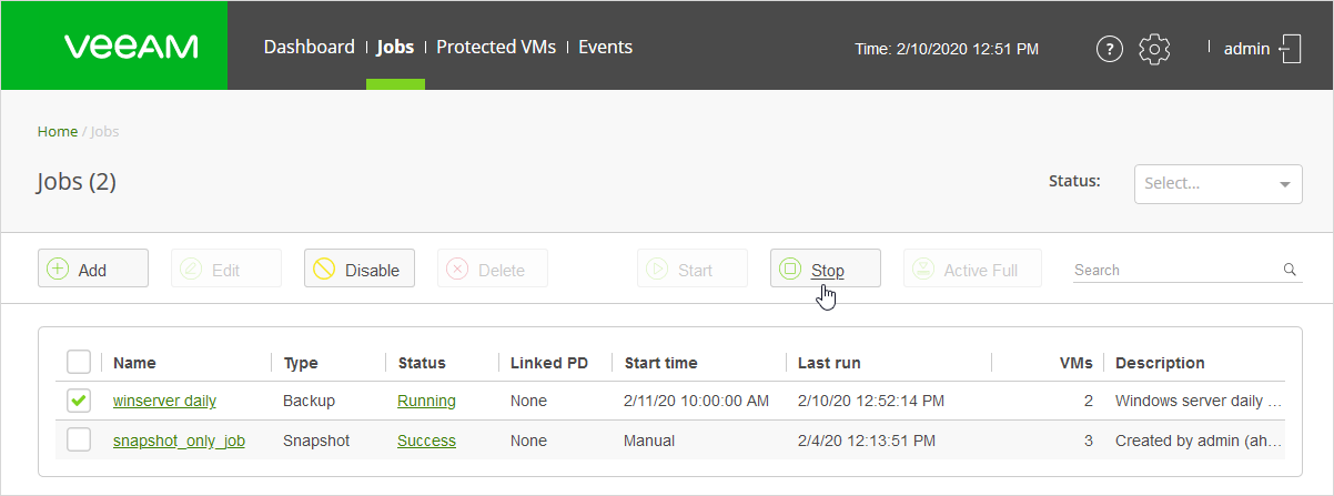

Stopping Jobs in AHV Backup Proxy Console
To stop a job in the AHV Backup Proxy web console:
- In the main menu, click Jobs.
- In the list of jobs, select a running job that you want to stop and click Stop on the toolbar.
- After you click Stop, AHV Backup Proxy will issue a warning that one or more instances will have incomplete, unusable restore points.
- In the displayed window, click OK.

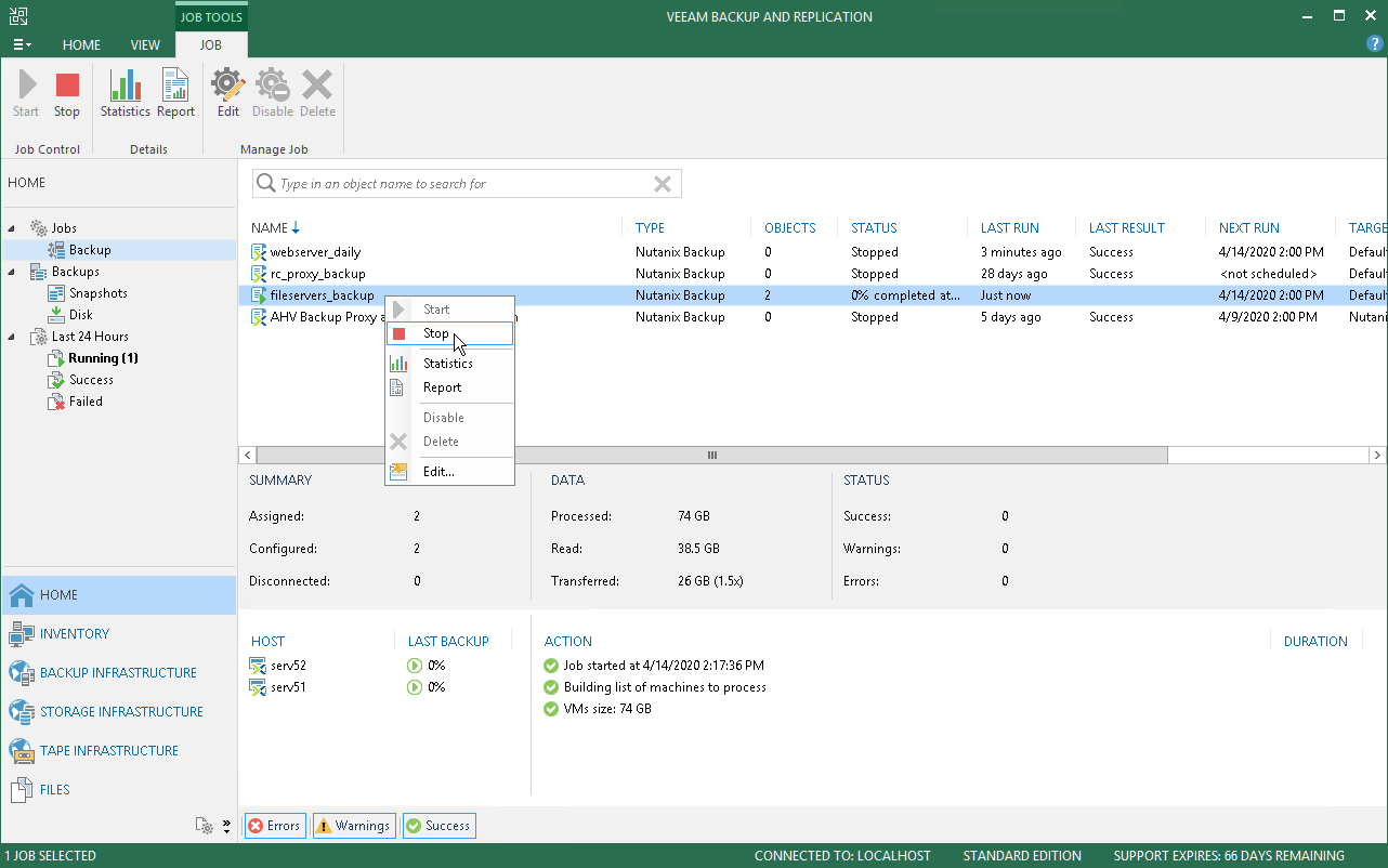

Stopping Jobs in Veeam Backup & Replication Console
To stop a job in the Veeam Backup & Replication console:
- Open the Home view.
- In the inventory pane, select Jobs.
- In the working area, select the job and click Stop on the ribbon or right-click the job and select Stop.
