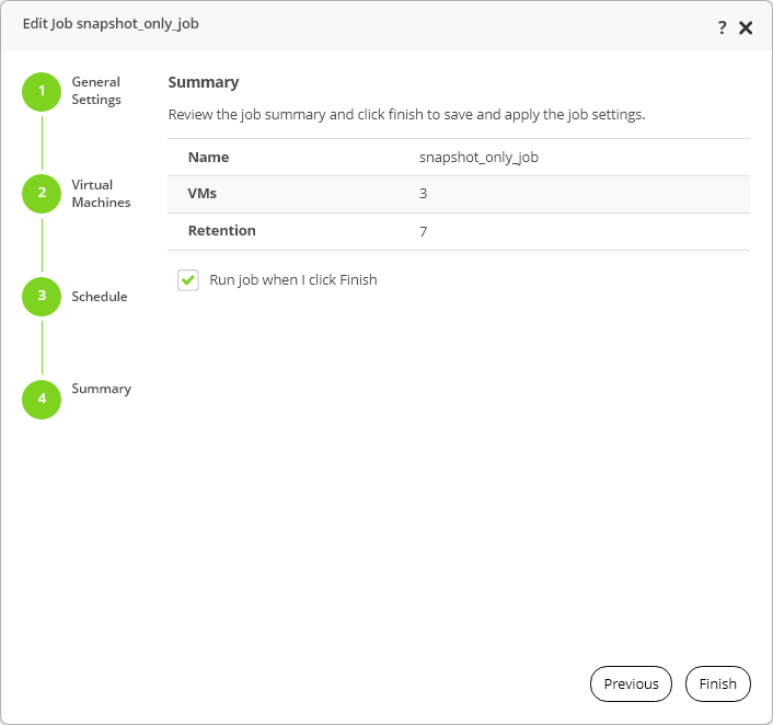

Step 4. Finish Working with Wizard
At the Summary step of the wizard, complete the procedure of snapshot job configuration.
  1. Review details of the snapshot job.
  2. Select the Run job when I click Finish check box if you want to start the job right after you finish working with the wizard.
  3. Click Finish to close the wizard.
