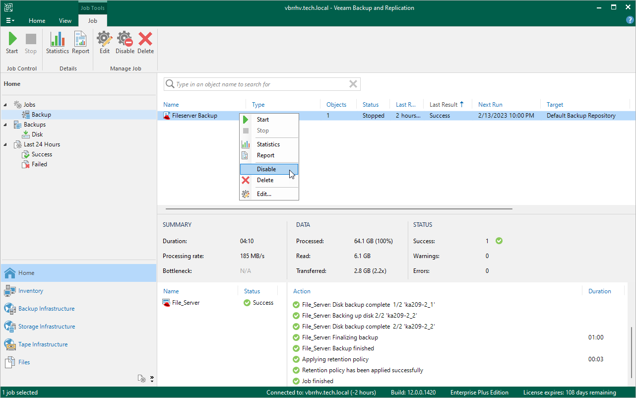

To enable or disable a backup job, do the following:
  2. In the inventory pane, select Jobs > Backup.
  3. In the working area, select the job and click Enable or Disable on the ribbon, or right-click the job and select Enable or Disable.
