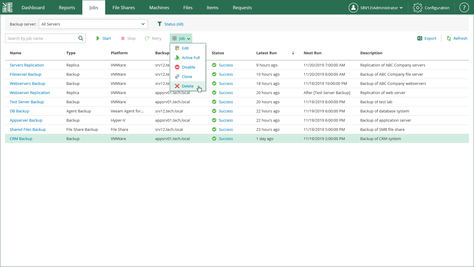

You can delete the job from configuration and also instruct Enterprise Manager to delete backup files created by this job in the backup repository.
To delete a job:
  1. Select the required job in the list on the Jobs tab.
  2. Expand the menu commands by clicking Job, then select Delete.

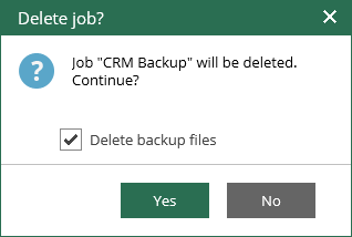

  1. You will be prompted to delete backup files. To delete backup files, select the Delete backup files check box and click Yes to confirm the operation.

Information about deleted jobs will be removed from Veeam Backup configuration database (and Enterprise Manager database, as well), and these jobs will no longer appear in the UI. If you agreed to delete backup files, they will be removed from backup repository.
