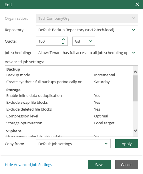

- On the vCloud tab, select the organization you need and click Edit.
- Edit the organization settings as necessary. If you want to display job settings applied to backup jobs for this organization, click Show advanced job settings in the window:
- In the Advanced job settings section you can examine existing job configuration.
- In the Copy from field you will see the name of a vCloud Director job previously selected as a template for this organization.
- To change the job that should be used as a template from that point forward, from the Copy from list select the job you need and click Apply.
