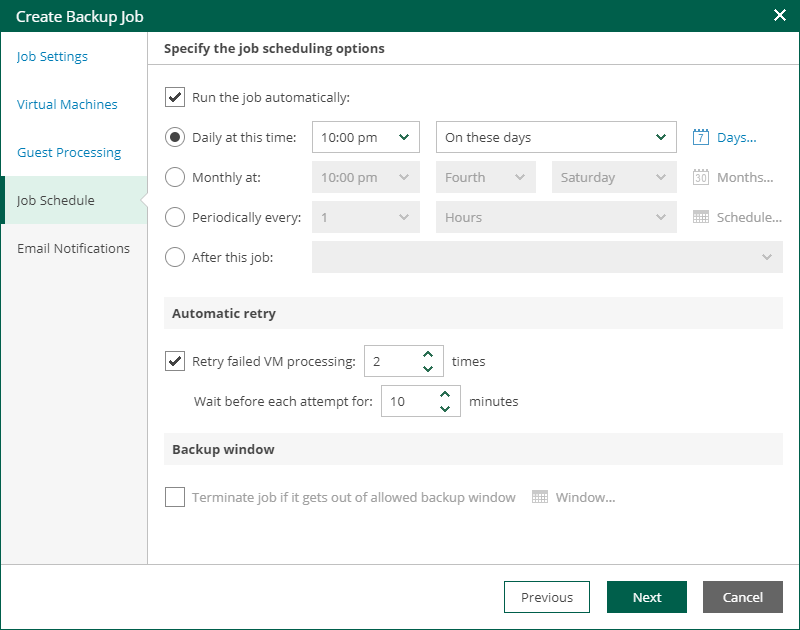

Step 6. Configure Job Schedule
At the Job Schedule step of the wizard, you can select to run the job manually or schedule the job to run on a regular basis.
To edit the job schedule:
  1. Select the Run the job automatically check box. If the check box is not selected, you will need to start the job manually.
  2. Edit the scheduling settings. You can select to run the job daily, monthly, periodically with a specific time interval, continuously or after a specific job.
For more information, see Schedule Settings.
  1. In the Automatic retry section, define whether Veeam Backup & Replication must attempt to run the backup job again if the job fails for some reason. During a job retry, Veeam Backup & Replication processes failed machines only. Enter the number of attempts to run the job and define time intervals between them. If you select continuous backup, Veeam Backup & Replication will retry the job for the defined number of times without any time intervals between the job runs.
  2. In the Backup window section, edit the time interval within which the backup job must complete. The backup window prevents the job from overlapping with production hours and ensures that the job does not provide unwanted overhead on the production environment. To set up a backup window for the job:
  1. Select the Terminate job if it gets out of allowed backup window check box and click Window.
  2. Define the allowed hours and prohibited hours for backup. If the job exceeds the allowed window, it will be automatically terminated.
Specifying Job Schedule Settings
If the Location property of the source object and target object do not match, you will receive a warning message after you click Finish. For example, you may have a backup job targeted at repository located in Sydney, and source machines located in London.
