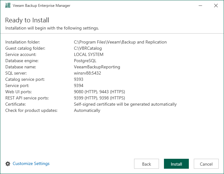

Step 6. Review Default Installation Settings
At the Ready to Install step of the wizard, you can select to install Veeam Backup Enterprise Manager with default installation settings or specify custom installation settings.
  • To use the default installation settings, click Install.
  • To use custom installation settings, click Customize Settings. The setup wizard will include additional steps that will let you configure installation settings.
The table below lists the default installation settings.
