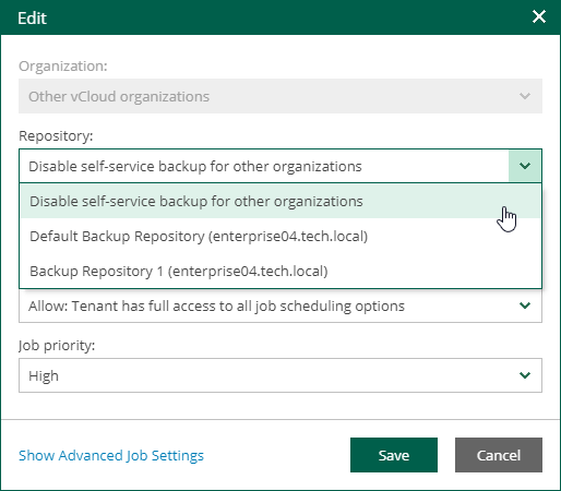

Disabling Default Configuration
The default configuration cannot be removed from the list — instead, you can disable it.
To disable the default configuration:
  1. Log in to Veeam Backup Enterprise Manager using an administrative account.
  2. Click Configuration in the top right corner.
  3. In the Configuration view, select the Self-service section.
  4. In the Self-service section, select the Cloud Director tab.
  5. On the Cloud Director tab, select the default organization configuration and click Edit.
  6. From the Repository drop-down list, select Disable self-service backup for other organizations.
