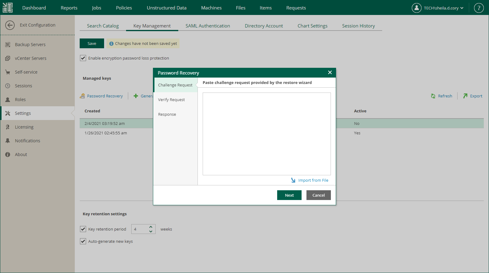

To decrypt your data, use the Password Recovery wizard within the following context:
  1. In Veeam Backup & Replication, you generate a request message for password restore. For more information, see the Create Request for Data Restore section of the Veeam Backup & Replication User Guide.
  2. In Veeam Backup Enterprise Manager, you start the Password Recovery wizard by clicking the Password Recovery button in Configuration > Key Management, and insert the text of the request to the wizard.
Handling Password Recovery Requests
  1. Veeam Backup Enterprise Manager finds a matching public backup server key in Veeam Backup Enterprise Manager database and decrypts the signature with this key.
  2. The wizard decrypts storage keys with the private Enterprise Manager key available on Veeam Backup Enterprise Manager, and generates a response. The response represents a text document and contains decrypted storage keys. Consider that the response is also encrypted and can be used only on the backup server where the request was issued.
  3. Then you can send the response back to requester, for example, by email. The requester will input this response to the Enterprise Keys Restore wizard on the Veeam backup server where the request was issued; Veeam Backup & Replication will process the response, retrieve the decrypted storage keys and use them to unlock encrypted backups or tapes and retrieve their content.
