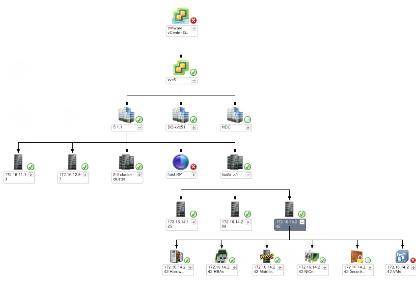

In normal operation, the _vCenter Compute Topology in OpsMgr shows a connected vCenter Server and its child objects (datacenters, clusters and vSphere hosts) similar to the hierarchy below.

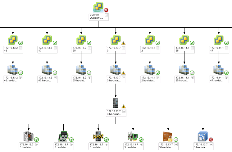

Veeam MP for VMware then rediscovers the VMware topology of hosts and VMs, and monitoring will continue. The _vCenter Compute Topology in OpsMgr illustrates the new connection method, with multiple direct-to-host connections replacing the failed vCenter Server connection:
