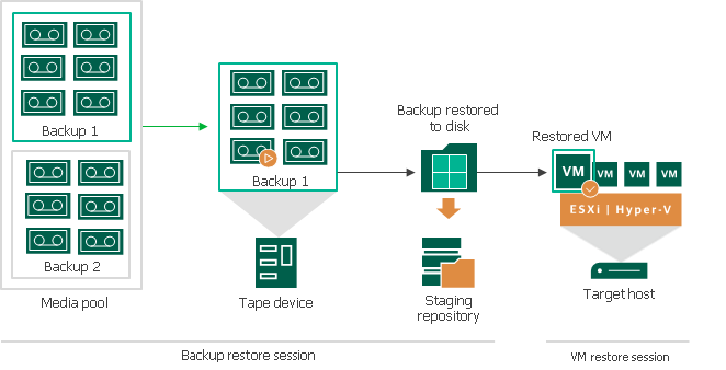

    Restore Through Staging Repository
    For restoring through a staging repository, Veeam Backup & Replication performs the following steps:
    1. Veeam starts 2 jobs at background:
    • Backup restore job: temporarily restores the backup to the repository.
    • VM restore job: restores the VM to the infrastructure.
    The jobs start simultaneously. The VM restore job starts and remains pending until the backup restore completes.
    1. The backup restore job checks the Backup Catalog in the Veeam Backup & Replication database to discover the tapes containing the needed backup. If the tapes are offline, Veeam Backup & Replication prompts the user to insert the required tapes.
    2. The backup restore job reads the tapes consecutively and copies the backup to the selected staging repository or folder.
    3. When the backup is copied, Veeam registers it temporarily as an imported backup.
    4. The backup restore job finishes.
    5. The VM restore job receives information about the backup restored successfully and launches a standard VM restore process. For more information, see Full VM Recovery.
    6. When the VM is successfully restored, the VM restore process finishes.
    7. Veeam deletes the backup from the staging repository and from disk.
