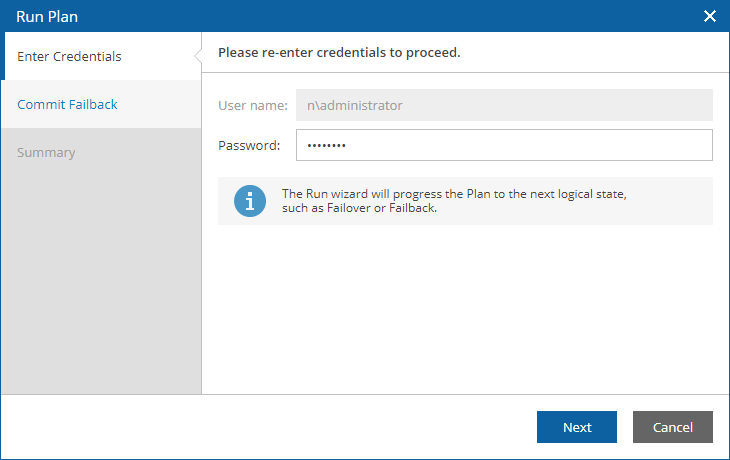

- Complete the Run Plan wizard.
- For security purposes, at the Enter Credentials step, re-type Site Administrator or Failover Plan Author password.

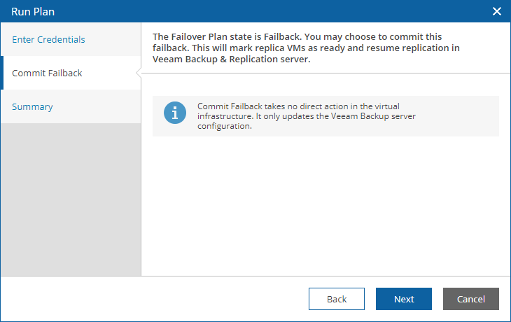

- At the Commit Failback step, review the description of the commit failback process.
