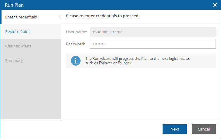

- For security purposes, at the Enter Credentials step, re-type Site Administrator or Failover Plan Author password.

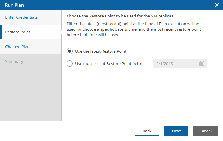

- At the Restore Point step, select a restore point that will be used to restore VM replicas.

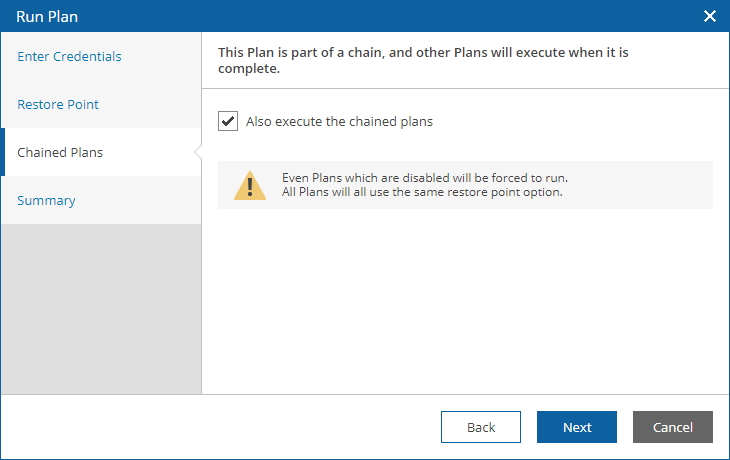

- [This step applies only if you have any other failover plans scheduled to run after the plan completes]
At the Chained Plans step, select the Also execute the chained plans check box to proceed to execution of subsequent failover plans after the current plan enters the FAILOVER state.
