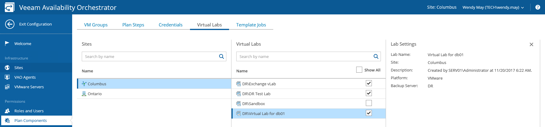

Unless a virtual lab is ENABLED for a VAO site, it will not be visible for use in failover plan testing for the site. To enable virtual labs for a VAO site:
  1. Log in to the VAO UI in the DR site as a DR Site Administrator. For details, see Accessing VAO UI.
  2. Switch to the Configuration tab.
  3. Navigate to Plan Components > Virtual Labs.
  4. Select the VAO site.
  5. In the Enable column of the Virtual Labs table, select and clear check boxes next to the necessary labs.
Enabling Virtual Labs
After you enable virtual labs for a VAO site, you become able to use these labs for on-demand or scheduled testing of your failover plans for the site. For more information, see Testing Failover Plans.
