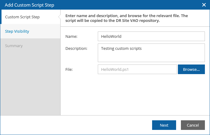

  1. At the Custom Script step, fill out the Name and Description fields, and browse to the script file.
Creating Custom Script Step

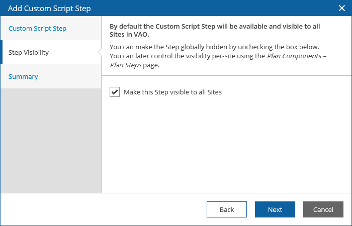

  1. At the Step Visibility step, use the Make this Step visible to all Sites check box to choose whether users of other VAO sites will be able to include the script in their failover plans.
If you do not select this check box, you can enable the script on a per-site basis. For more information on enabling plan steps, see Configuring Veeam Availability Orchestrator.
