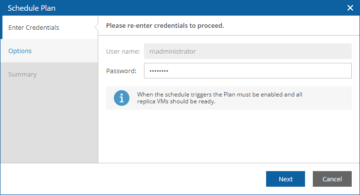

- For security purposes, at the Enter Credentials step, re-type Site Administrator or Failover Plan Author password.

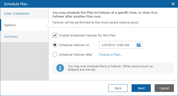

- At the Options step, select the Enable Scheduled Failover for this Plan check box, and choose whether you want to run the plan on schedule or after any other plan.
If you want to run the plan at specific time, select the Schedule Failover on option and choose the date and time.
If you want to run the plan after another plan, choose the Schedule Failover after option and select the preceding plan.
