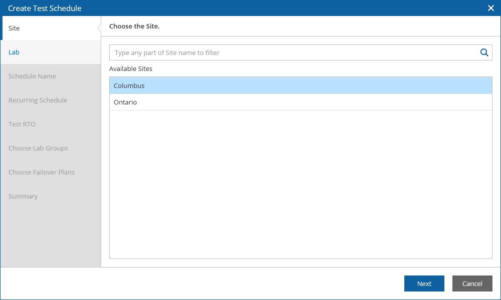

At the Site step, in the Available Sites list, select a VAO site for which you want to create the schedule.
Configuring Test Scheduling

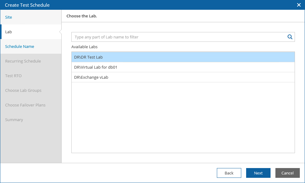

At the Lab step, select the virtual lab which you want to use to verify failover plans.

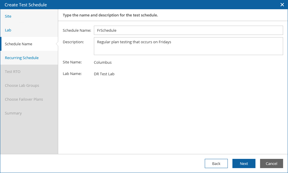

At the Schedule Name step, specify a name and description for the schedule.

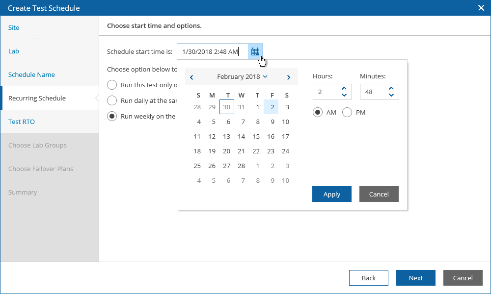

At the Recurring Schedule step, define scheduling settings for the lab:
  1. Click the Schedule icon next to the Schedule start time is field, configure the necessary schedule, and click Apply.
  2. Choose the necessary option:
Run this test only once at the above time to test the plan once on the specified day.
Run daily at the same time to start testing at specific time every day.
Run weekly at the same day to start testing once a week on the specified day.

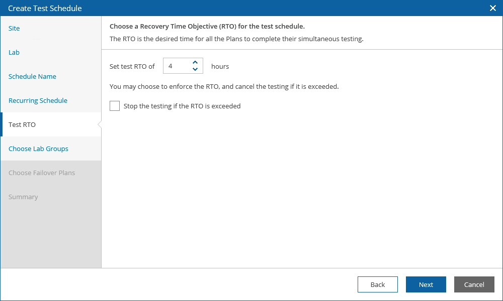

At the Test RTO step, use the Set test RTO of <n> hours field to specify the time period during which plan testing must complete to comply with your RTO requirements.
You can also select the Stop the testing if the RTO is exceeded check box to power off plan testing if its duration exceeds the preferred time limit.

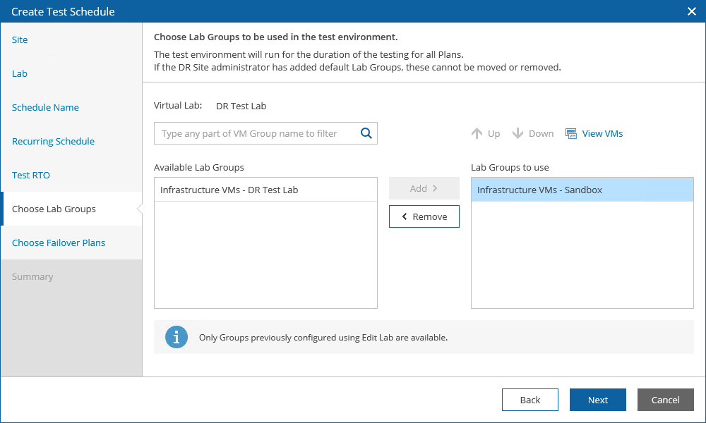

At the Choose Lab Groups step, add the required lab groups to support the test environment:
  • Use the Add and Remove controls to manage previously configured lab groups.
  • Use the Up and Down arrows to change the group execution order.
Configuring Test Scheduling Note:
All default lab groups previously created by a DR Site Administrator will automatically become preselected in the Lab Groups to use list, and you will not be able to remove them or modify the order in which they will run. For more information, see Working with Default Lab Groups.

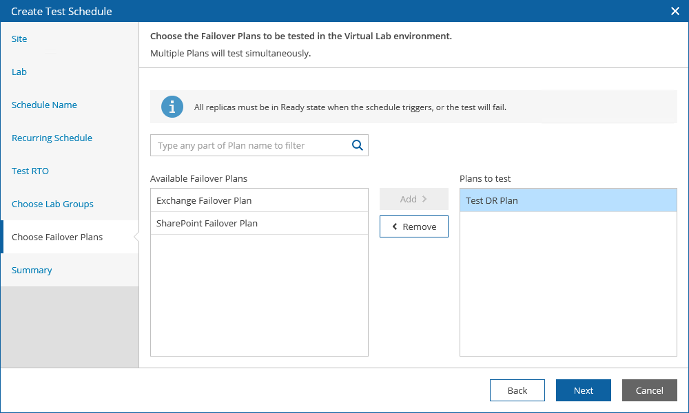

At the Choose Failover Plans step, select failover plans to be tested in the virtual lab. Use the Add and Remove controls to manage available plans.
If you select several failover plans, they all will be tested at the same time.
