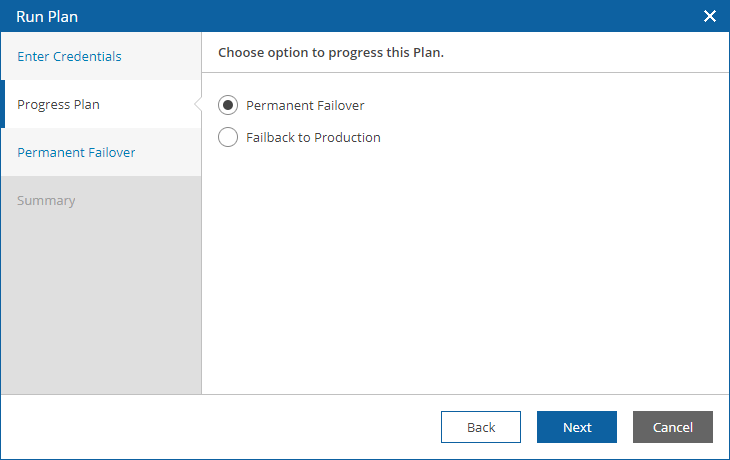

  1. For security purposes, at the Enter Credentials step, re-type Site Administrator or Failover Plan Author password.
Running Permanent Failover
  1. At the Progress Plan step, select Permanent Failover.

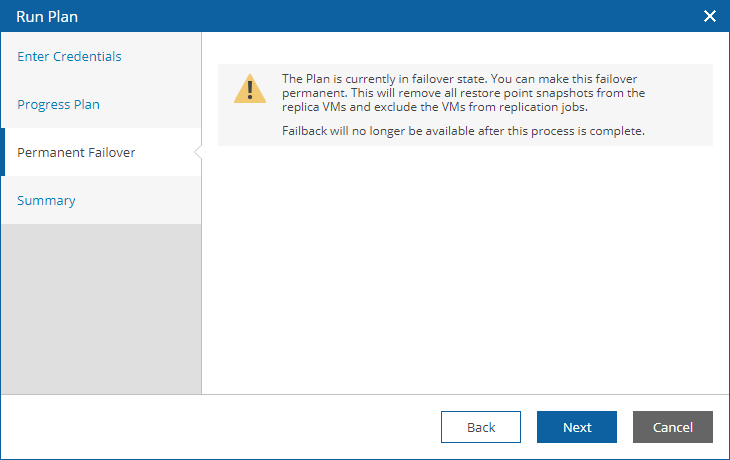

  1. At the Permanent Failover step, review the description of the permanent failover process.
Running Permanent Failover Note:
Failback will not be an option once the permanent failover process is over.
