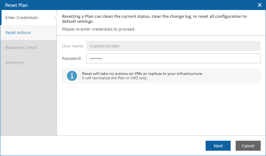

- For security purposes, at the Enter Credentials step, re-type Site Administrator or Failover Plan Author password.

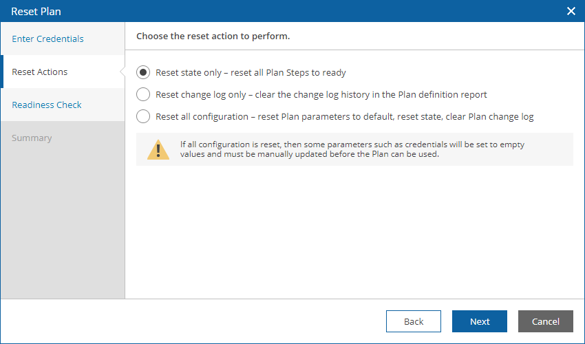

- At the Reset Actions step, choose whether you want to reset the plan state, clear the change log history in the Plan Definition Report, or reset all configuration and revert all parameters to default.

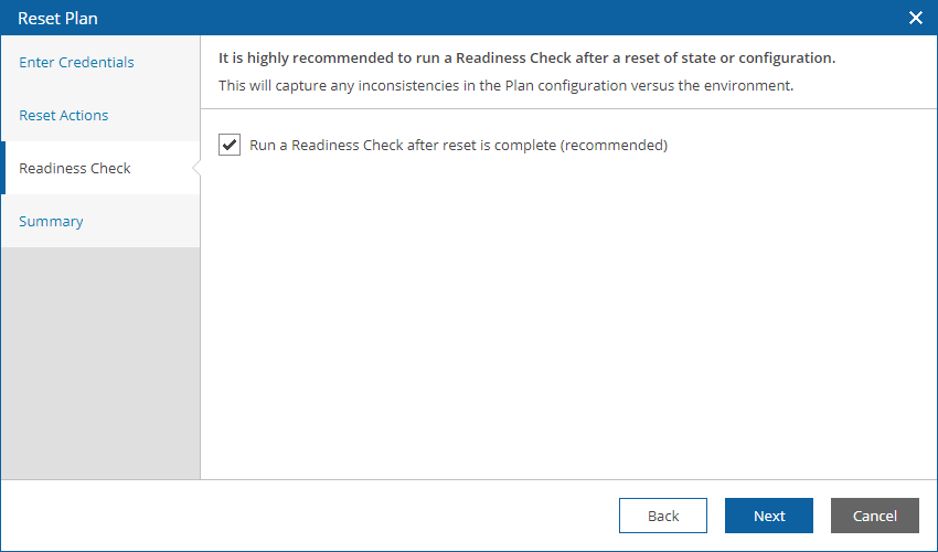

- At the Readiness Check step, select the Run a Readiness Check after reset is complete check box to run a readiness check to confirm that the changes are valid.
