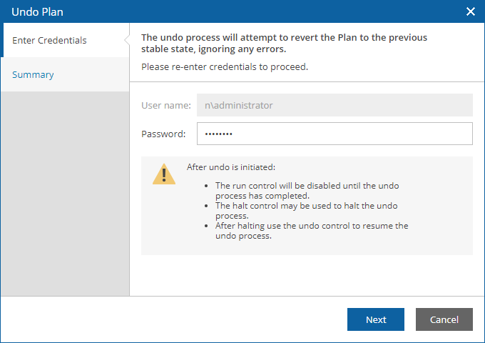

- Complete the Undo Plan wizard.
- For security purposes, at the Enter Credentials step, re-type Site Administrator or Failover Plan Author password.
