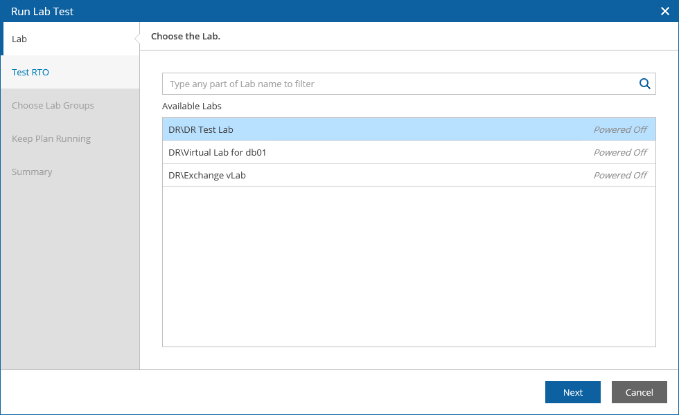

At the Lab step, select the virtual lab in which the plan will be verified.

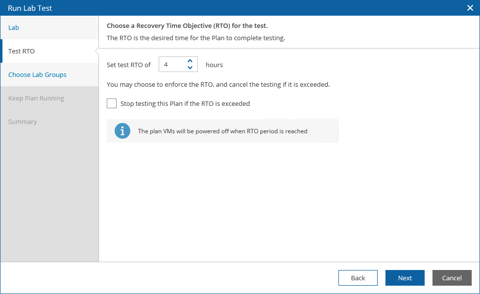

At the Test RTO step, use the Set test RTO of <n> hours field to specify the time period during which plan testing must complete to comply with your RTO requirements.
You can also select the Stop testing this Plan if the RTO is exceeded check box to power off plan testing if its duration exceeds the preferred time limit.

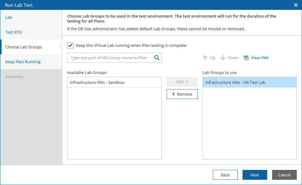

At the Choose Lab Groups step, add the required lab groups to support the test environment:
- Use the Add and Remove controls to manage previously configured lab groups.
- Use the Up and Down arrows to change the group execution order.
- Select the Keep this Virtual Lab running when Plan testing is complete check box if you are willing to perform further tests.
All default lab groups previously created by a DR Site Administrator will automatically become preselected in the Lab Groups to use list, and you will not be able to remove them or modify the order in which they will run. For more information, see Working with Default Lab Groups. |
