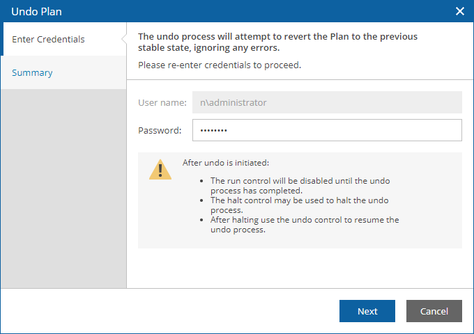

To perform an undo operation for a HALTED failover plan:
- Select the plan. From the Launch menu, select Undo.
-OR-
Click the plan name to switch to the Plan Details page, and click Undo.
- Complete the Undo Plan wizard.
- For security purposes, at the Enter Credentials step, re-type Site Administrator or Failover Plan Author password.
- At the Summary step, review configuration information and click Finish. The failover process will be started.
