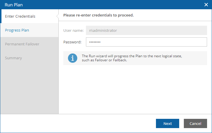

  1. Complete the Run Plan wizard.
  1. For security purposes, at the Enter Credentials step, re-type Site Administrator or Failover Plan Author password.
Running Failback
