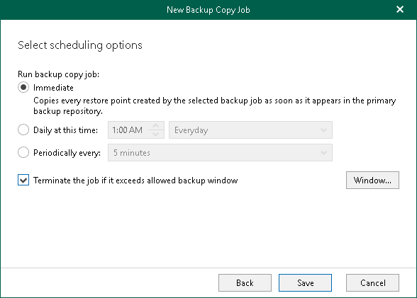

Step 3. Specify Scheduling Options
At this step of the wizard, configure a schedule for your backup copy job.
To configure a schedule, do the following:
- In the Run backup copy job section, select one of the following options:
- Immediate. Select this option if you want to run the backup copy job right after the latest restore point appears in the source backup repository. Veeam Backup for Microsoft 365 copies each restore point created by the source backup job (backup job for which you create a backup copy job).
- Daily at this time. Select this option if you want to run the backup copy job on the specified days at the specified hours.
- Periodically every. Select this option if you want to run the backup copy job every N minutes or hours.
Mind that if you run your backup copy job daily or periodically, Veeam Backup for Microsoft 365 copies only the latest restore point that appeared in the source backup repository since the last run of this backup copy job.
- Select the Terminate the job if it exceeds allowed backup window check box, click Window and specify allowed and prohibited hours for the backup copy job. For more information, see Selecting Time Periods.
