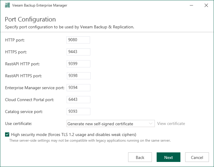

The REST API certificate is configured during Enterprise Manager installation:
  • If you install Enterprise Manager on Linux, a self-signed certificate is generated.
  • If you install Enterprise Manager on Microsoft Windows, you can select an existing certificate or generate a new self-signed certificate.

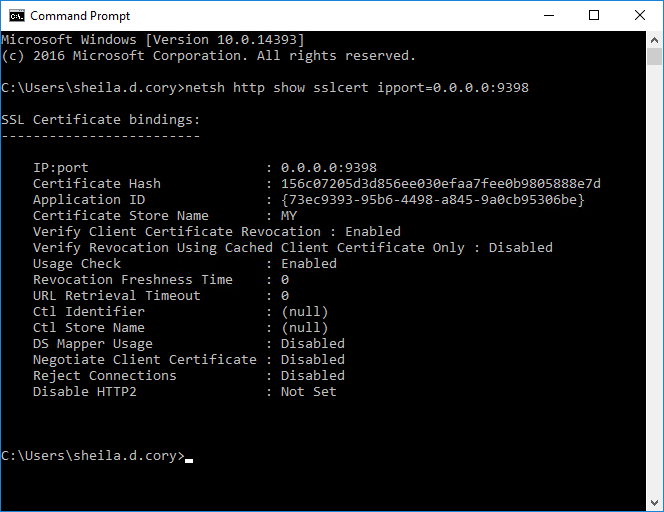

If the existing TLS certificate expires or you want to replace it (for example, with a certificate issued by a Certificate Authority), you can update the current certificate in the Enterprise Manager web UI. For details, see the Installing Certificates section of the Veeam Backup Enterprise Manager User Guide.
