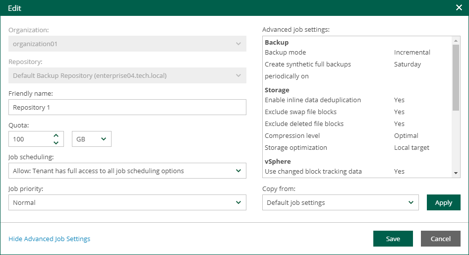

To edit an organization configuration:
  1. Log in to Veeam Backup Enterprise Manager using an administrative account.
  2. Click Configuration in the top right corner.
  3. In the Configuration view, select the Self-service section.
  4. In the Self-service section, select the vCloud tab.
  5. On the vCloud tab, select an organization configuration and click Edit.
  6. To edit organization settings, follow the same steps as for adding a configuration.
For more information, see Adding Organization Configuration.
