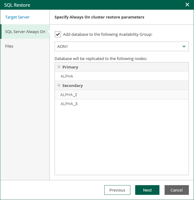

- If AlwaysOn Availability Groups are present on the target server, at the SQL Server Always On step of the wizard, you can add the restored database to an Availability Group.

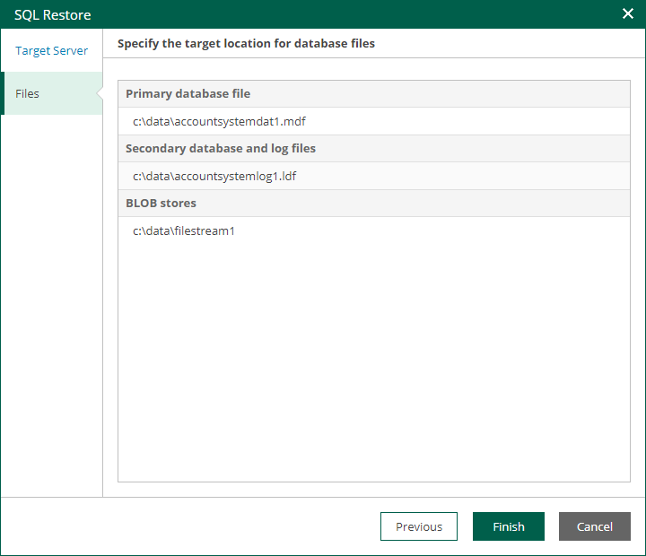

- At the Files step of the wizard, you can specify paths to database files on the target server. You can specify separate target locations for the primary database file and secondary database file with logs.
