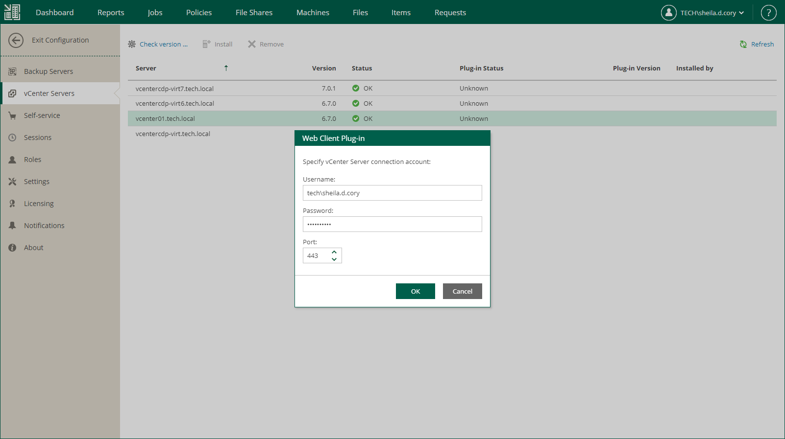

- In the Configuration view, go to the vCenter Servers section.
- Select the vCenter Server you need, and click Check version.
- In the Web Client Plug-in window, enter a user name and password to connect to the vCenter Server, and specify a connection port (default port is 443). Veeam Backup Enterprise Manager will use these credentials to access the vCenter Server and check if Veeam plug-in has been already installed there. If discovered, the plug-in version will be displayed in the Plug-in Version column.
- If the connection to vCenter Server is successful, and the plug-in has not been installed yet, then the Install link will become active. Click it to install the plug-in.
- After installation, the plug-in will be displayed in the list of vCenter Servers and plug-ins.

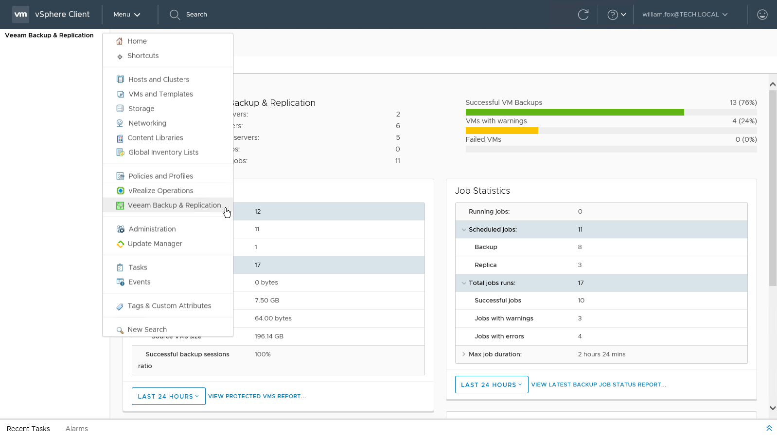

Accessing Plug-in from vSphere Web Client
To access the plug-in from VMware vSphere Web Client, launch the vSphere Web Client and select Veeam Backup & Replication from the menu.
