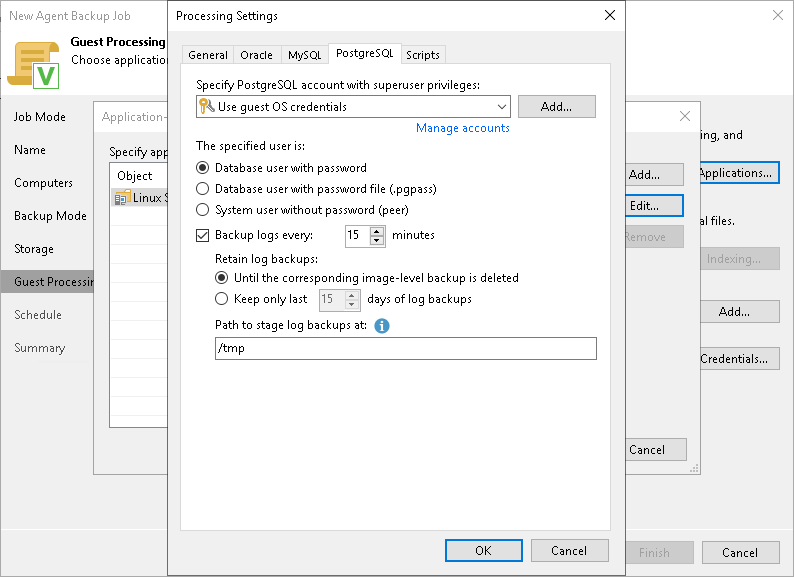

  1. At the Guest Processing step of the wizard, click Applications.
  2. In the Application-Aware Processing Options window, select the necessary object, click Edit, then click the PostgreSQL tab.
  3. On the PostgreSQL tab, specify a user account that Veeam Agent for Linux will use to connect to the PostgreSQL database. You can do one of the following:
  • Select from the Specify PostgreSQL account with superuser privileges list a user account that has the required rights for the database.
If you have not set up credentials beforehand, click the Manage accounts link or click Add on the right to add credentials. With this option selected, Veeam Agent for Linux will connect to the PostgreSQL database under the account that you have selected in the Specify PostgreSQL account with superuser privileges list.

  1. In the The specified user is field, specify how Veeam Agent will connect to the PostgreSQL database.
The The specified user is field is connected closely with the Specify PostgreSQL account with superuser privileges list. Veeam Agent will do the following depending on what you specified using these two controls.

  1. To back up PostgreSQL archived logs with Veeam Agent, select the Backup log every <N> minutes check box and specify the frequency for archived logs backup. By default, archived logs are backed up every 15 minutes. The minimum log backup interval is 5 minutes. The maximum log backup interval is 480 minutes.
  2. In the Retain log backups section, specify retention policy for archived logs stored in the backup location:
  • Select Until the corresponding image-level backup is deleted to apply the same retention policy for Veeam Agent backups and archived log backups.
  • Select Keep only last <N> days to keep archived logs for a specific number of days. By default, archived logs are kept for 15 days. If you select this option, you must make sure that retention for archived logs is not greater than retention for the Veeam Agent backups. The maximum time period to keep archived logs is 60 days.
  1. In the Path to stage log backups at field, specify temporary storage location for the archive logs.
