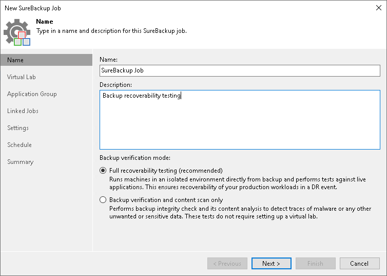

  • For backups created with Veeam Agents, you cannot exclude objects from the scope of the SureBackup job at the Linked Jobs step of the New SureBackup Job wizard.
  • [For full recoverability testing mode] SureBackup is not supported for backups containing drives greater than 64 TB.

  • SureBackup job in the Backup verification and content scan only mode is not supported.
