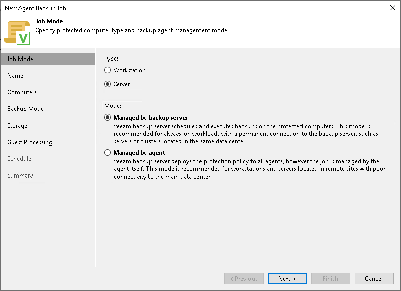

Step 2. Select Job Mode
At the Job Mode step of the wizard, specify protection settings for the Veeam Agent backup job managed by the backup server:
  1. Select the type of protected computers whose data you want to back up with Veeam Agents.
  2. If you choose to back up data on servers, select the job mode.
Selecting Protected Computer Type
To create a Veeam Agent backup job managed by the backup server, at the Job Mode step of the wizard, in the Type field, select the Server option.
NOTE
You cannot select the Workstation option if you want to create a Veeam Agent backup job managed by backup server.
Selecting Job Mode
If you selected the Server option in the Type field, in the Mode field, select the Managed by backup server job mode to create a Veeam Agent backup job managed by the backup server. If you select the Managed by agent job mode, you will create a Veeam Agent backup policy.
