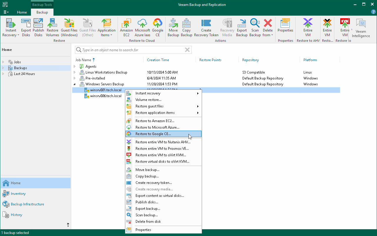

You can use the Veeam Backup & Replication console to restore computers from Veeam Agent backups to Google Compute Engine.

The procedure of restore to Google Compute Engine from a Veeam Agent backup practically does not differ from the same procedure for a VM backup. To learn more about restore to Google Compute Engine, see the Restoring to Google Compute Engine section in the Veeam Backup & Replication User Guide.
